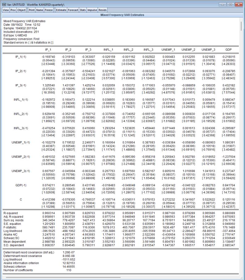

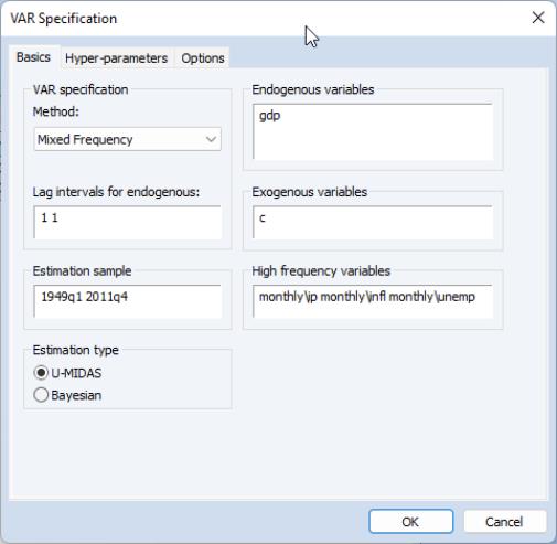

Following Ghysels, we will estimate a mixed frequency VAR model with a single lag. Ensuring we have the quarterly page selected, we click on Quick/Estimate VAR… menu item and fill in the details of our VAR. To begin we will estimate a U-MIDAS model with the single quarterly variable, GDP, and three monthly variables:
Clicking on OK produces the result:
Each of the monthly variables, IP, INFL and UNEMP have been transformed into three separate variables in the quarterly VAR, one variable for each month in the quarter. The “_i” suffix is used to distinguish each month.

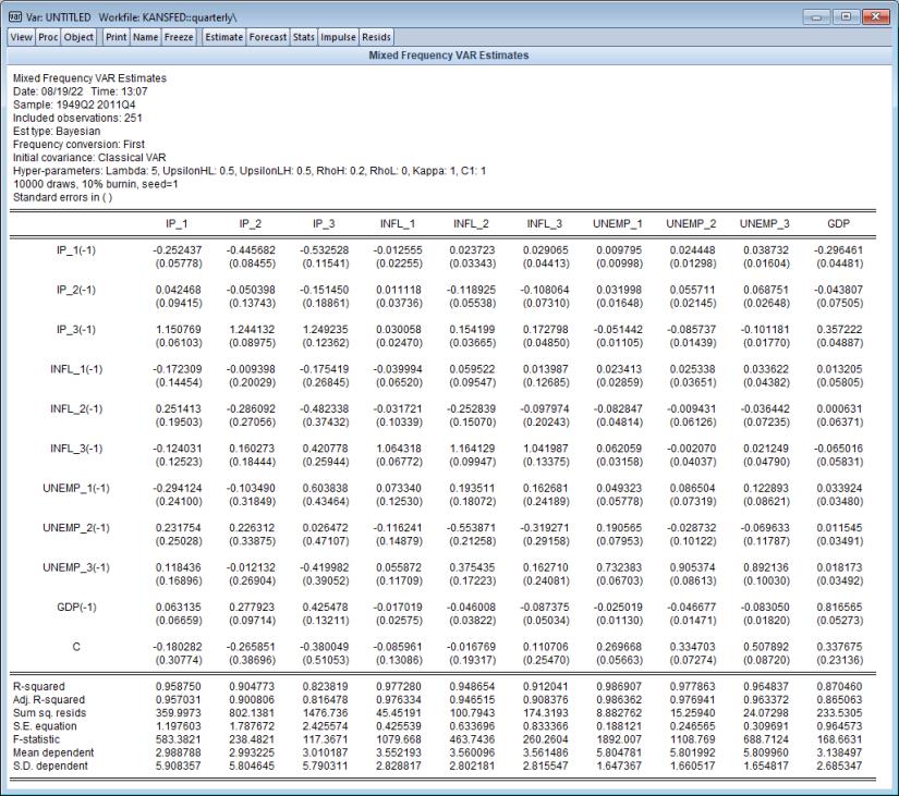

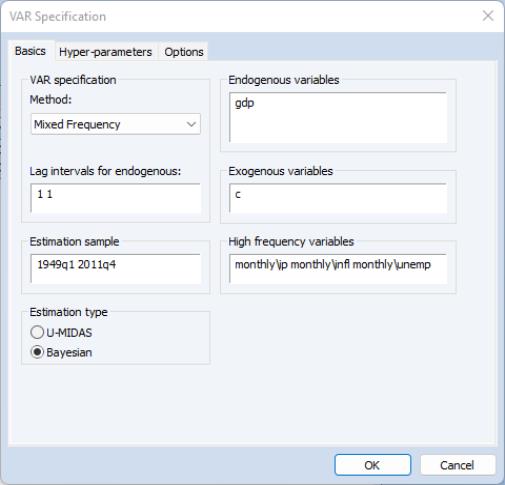

In his paper, rather than estimating with U-MIDAS, Ghysels estimates using a Bayesian prior, which we can replicate by clicking Estimate to bring up the VAR Specification dialog and selecting Bayesian as the Estimation type:
Clicking on OK produces:
These results are in line with those reported in Table 5 of Ghysels and show a reasonable difference from the U-MIDAS/classical VAR we first estimated – for example the coefficient on the first monthly observation of IP on a single quarterly lag of itself changes from -0.17 to -0.25.
