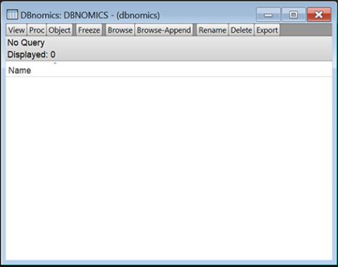

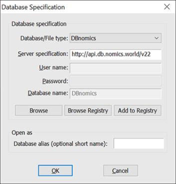

EViews offers a custom interface to the DBnomics data. To open the DBnomics database, select File/Open Database… from the main EViews menu, then select DBnomics from the Database/File type dropdown menu:
When you click on OK, EViews will open a standard database window:
Click on Browse to open the custom DBnomics window:

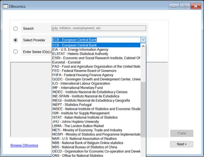

To select by data provider, click the radio button Select Provider and choose one of the entries listed in the drop-down box:

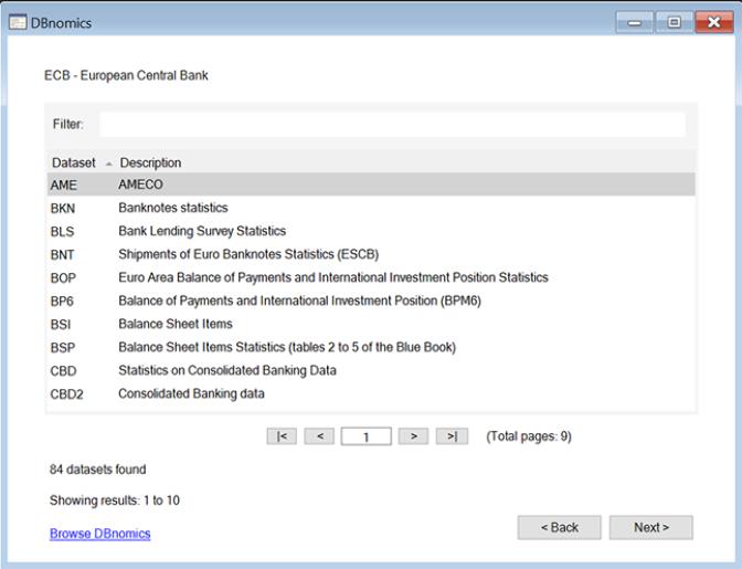

Use the Next button to view the results in a dialog that contains a table with all datasets related to the specified provider (in this case, ECB):
The interface provides a way to filter through the results by typing a keyword in the Filter textbox. It also provides a textbox and buttons to navigate through multiple pages of results. Click the Next button or double-click on a row to select a dataset.

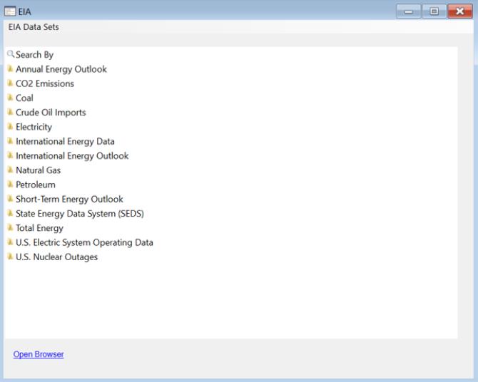

To open the EIA online database, simply select File/Open Database… from the main EViews menu, then select EIA - U.S. Energy Information Administration from the Database/File type dropdown menu:
The server specification will be automatically filled in with the EIA server address api.eia.gov. This does not need to be changed. Click on OK to proceed.

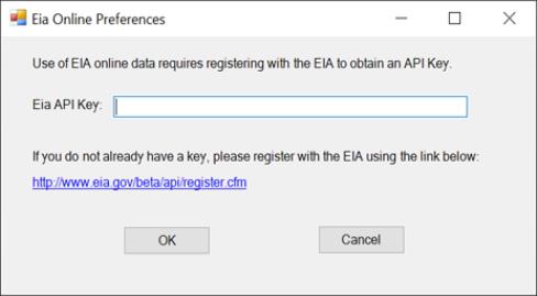

Use of the EIA online service is free but requires registration. The first time you attempt to open the EIA online database you will be asked to enter an API Key obtained from the EIA:
Please enter your API key and click on OK. The key will be saved as a user specific setting in your EViews “.ini” file. If you need to change the key at a later time, use View/Preferences… from the EViews database menu to bring up the dialog again so you can modify your settings.

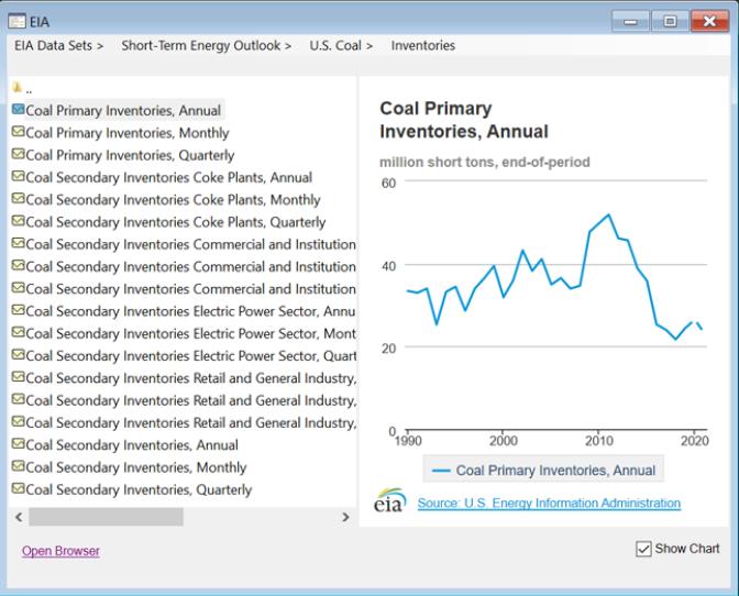

The EIA database connection supports a custom browser window for navigating through the EIA data. Click on Browse to open the custom browser window. The standard database window will be minimized and the EIA browser window will open:
The browser window displays a Search By link and the data sets available within the database as a set of folders, where each folder may contain additional folders or a list of series available for download. Clicking on a folder moves you into that folder and adds the folder to the path displayed at the top of the window:
You can return to the previous folder by clicking on the “..” folder icon at the top of the list, or move directly to any folder within the current path by clicking on the path component at the top of the window.
Select the Show Chart box to view a chart of a selected series:

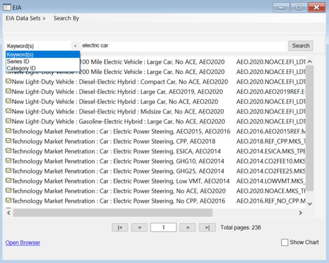

Additionally, the EIA Edx allows the user to search for one or multiple series. Click on the Search By link to search for series by Keyword(s), Series ID, or Category ID.
You can select the Show Chart box to view the chart of a selected series:

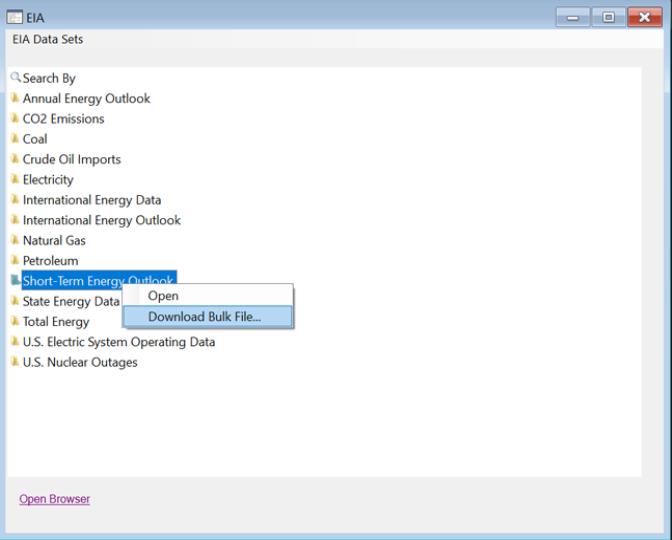

To download a bulk file, open the browser window of the EIA online database, right click on a data set, then select Download Bulk File…:
A dialog will appear giving instructions for downloading the file and preparing it for use by EViews:

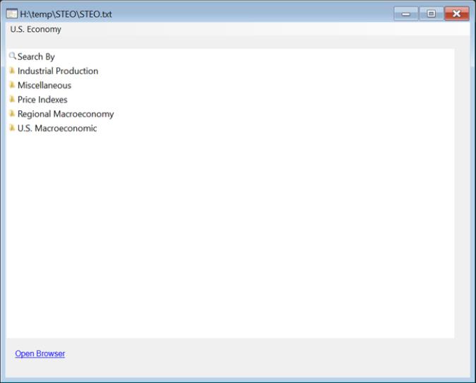

Once the bulk file is ready, use File/Open Database… to browse to the file and click OK to open it:
Alternatively, you can drag and drop the file onto EViews to open it. First, however, you should rename the “.txt” file to “.eia” so EViews can tell that the file contains data in EIA bulk file format and is not a generic text file.
The caption on the window indicates that you are working with a local file. Otherwise, the interface behaves the same as when working with online data:

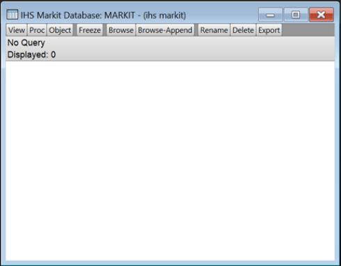

EViews offers a custom interface to IHS Markit data. To open the database, select File/Open Database… from the main EViews menu, then select IHS Markit from the Database/File type dropdown menu:
You are required to enter Username and Password information before you click on OK. EViews will verify your user information and open a standard database window:

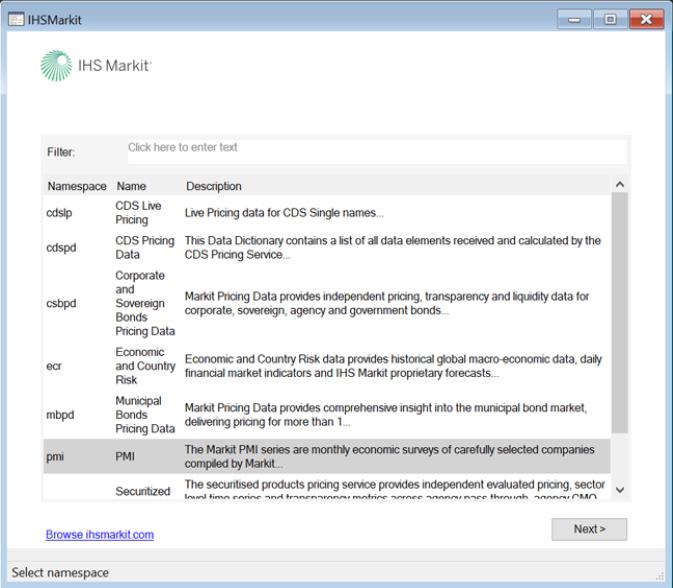

Click on Browse to open the custom IHS Markit window:
The dialog allows you to select data available within datasets using the Namespace field. You may also search through the datasets by typing a keyword in the Filter textbox. For this example, select a dataset and click the Next button:

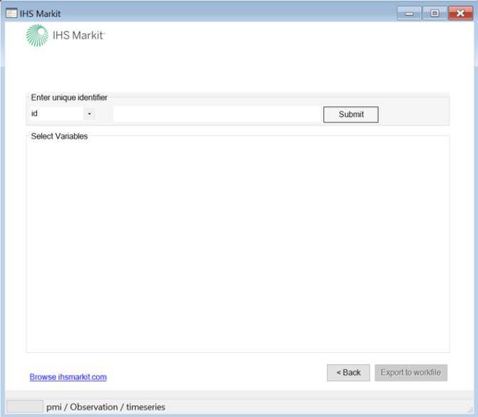

Select the type of identifier (id, cusip, isin, etc.) you want to use in the drop-down box. Type or paste a unique id and click the Submit button:

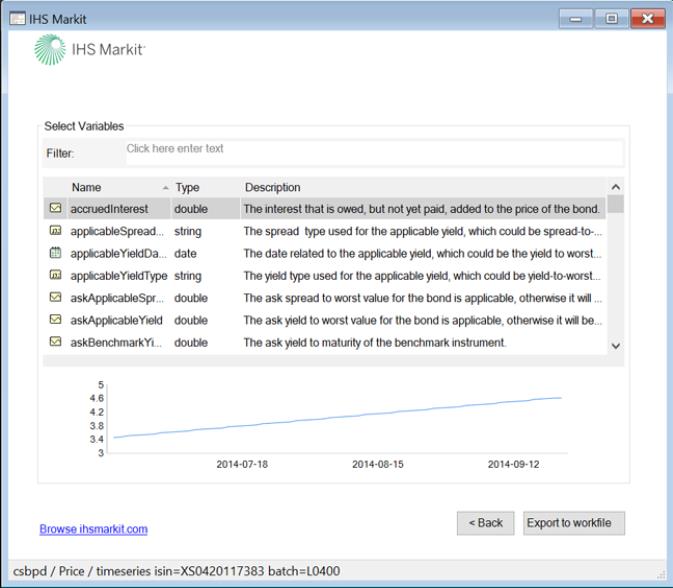

The dialog interface will display the list of variable names, their types, and a description. Type a keyword in the Filter textbox to filter the results. The interface also provides a graph preview of the series data selected. Once you have found and selected the series of interest, you may drag-and-drop or click the Export to workfile button to export the series directly into a new or preexisting EViews workfile.

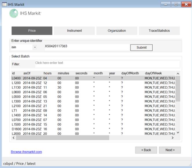

Pricing data in several datasets is organized into batches:
When batch information is available, after a unique id is entered the results table will show a list of batch-ids and metadata information. Type a keyword in the Filter textbox to filter the results.
Note that in the example shown in the dialog above, there are four tabs/buttons (Price, Instrument, Organization, TraceStatistics). The IHS Markit API identifies these as Entities and they represent additional categories with uniquely identified records. In the above example we have selected Price (the Entity Price defines the price, yield, spreads and other metrics of an instrument.).
Select a batch id and click the Next button:

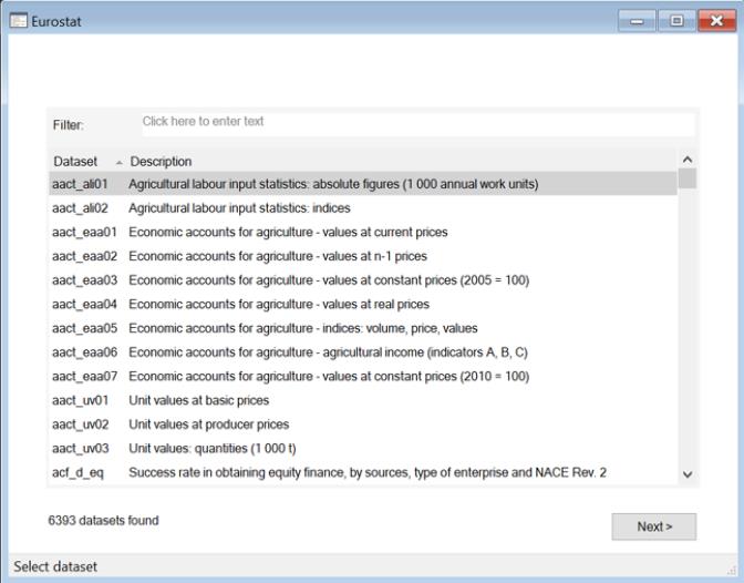

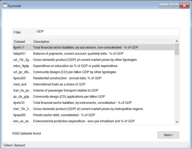

Here we see the interface to the Eurostat data:
The dialog allows you to select data available within datasets. The browser interface to the data provides a way to search through the datasets by typing a keyword in the Filter textbox:

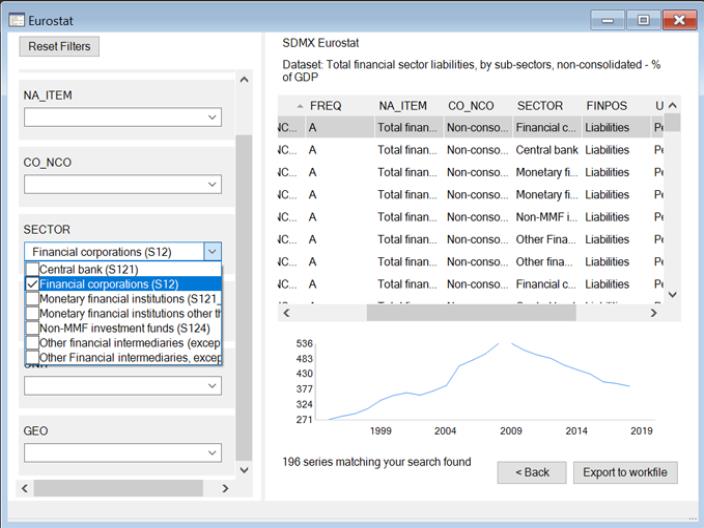

Select a dataset and click the Next> button to display a dialog where you can view and select series:
The dialog contains a table with all series matching the search. The interface provides a list of dropdown boxes that contain additional search filter criteria. Clicking a filter drop box, a user can select one or more options. When selection is finished the results of series will be updated to match the filter options.
Once you have found and selected the series of interest, you may drag-and-drop or click the Export to workfile button to export the series directly into an EViews existing or new workfile in the usual fashion.
