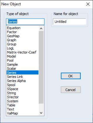

One method of creating a numeric series is to select from the menu, and then to select . You may, at this time, provide a name for the series, or you can let the new series be untitled. Click on .
EViews will open a spreadsheet view of the new series object. All of the observations in the series will be assigned the missing value code “NA”. You may then edit or use expressions to assign values for the series.

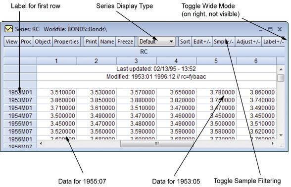

Changing the Spreadsheet Display
EViews provides you with extensive ability to customize your series spreadsheet display.
Column Widths
To resize the width of a column, simply move your mouse over the column separator until the icon changes, then drag the column to its desired width. The new width will be remembered the next time you open the series and will be used when the series is displayed in a group spreadsheet.

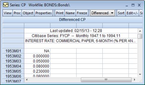

The series display type, which is listed in the dropdown menu in the series toolbar, determines how the series spreadsheet window shows your data.
The method shows data in either raw (underlying data) form or, if a value map is attached to the series, shows the mapped values. Alternatively, you may use the to show only the underlying data. See
“Value Maps” for a description of the use of value maps.
You may also use the display type setting to show transformations of the data. You may, for example, set the display method to , in order to have EViews display the first-differences of your data. Annual-based transformations for daily and weekly data was removed in EViews 13
Changing the display of your series values does not alter the underlying values in the series, it only modifies the values shown in the spreadsheet (the series header, located above the labels, will also change to indicate the transformation). Note, however, that if you edit the values of your series while displayed in transformed mode, EViews will change the underlying values of the series accordingly. Changing the display and editing data in transformed mode is a convenient method of inputting data that arrive as changes or other transformed values.

Narrow versus Wide
The narrow display displays the observations for the series in a single column, with date labels in the margin. The typical series spreadsheet display will use this display format.
The wide display arranges the observations from left to right and top to bottom, with the label for the first observation in the row displayed in the margin. For dated workfiles, EViews will, if possible, arrange the data in a form which matches the frequency of the data. Thus, semi-annual data will be displayed with two observations per row, quarterly data will contain four observations per row, and 5-day daily data will contain five observations in each row.
You can change the display to show the observations in your series in multiple columns by clicking on the button on the spreadsheet view toolbar (you may need to resize the series window to make this button visible). For example, toggling the button switches the display between the wide display (as depicted), and the narrow (single column) display.
This wide display format is useful when you wish to arrange observations for a particular season in each of the columns.

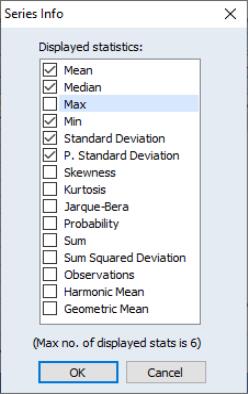

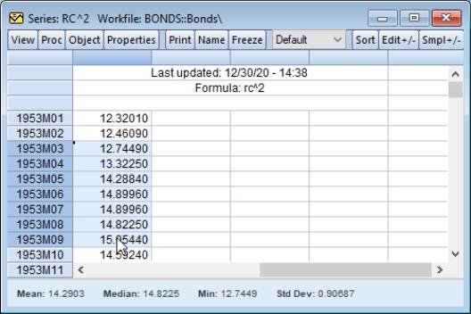

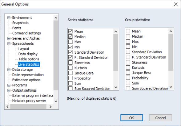

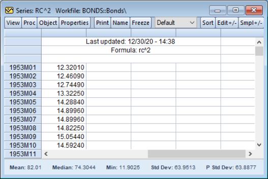

Live statistics
The series and group spreadsheet views now display interactive statistics. When a spreadsheet is first opened the statistics are computed using all of the data in the spreadsheet.
Double-clicking on the bottom bar of the series window brings up a menu where the statistics shown can be changed. A maximum of six statistics may be displayed at once. The window may need to be resized to display all the statistics.
The statistics are recalculated every time a group of cells is highlighted.
The statistics displayed can also be set by going to from the main menu and then the page.

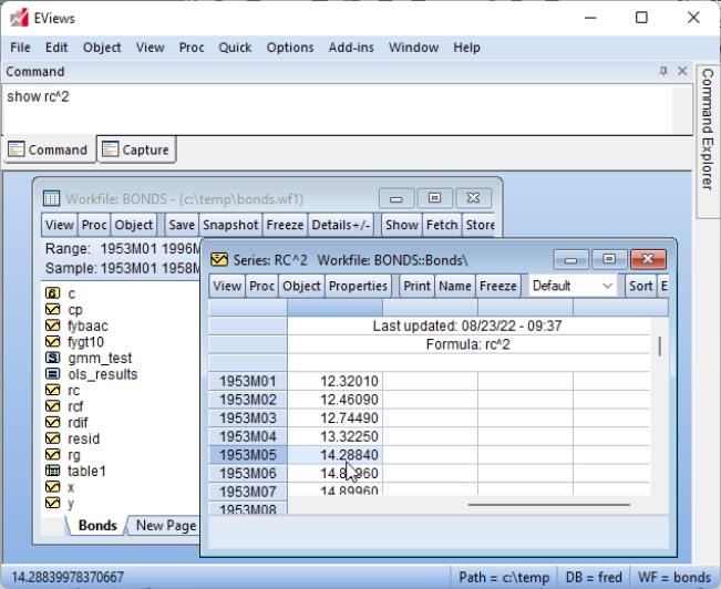

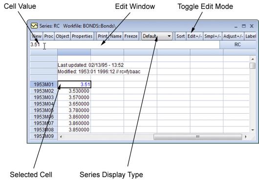

Editing a series
You can edit individual values of the data in a series.
First, open the spreadsheet view of the series. If the series window display does not show the spreadsheet view, click on the button, or select , to change the default view.
Next, make certain that the spreadsheet window is in edit mode. EViews provides you with the option of protecting the data in your series by turning off the ability to edit from the spreadsheet window. You can use thebutton on the toolbar to toggle between edit mode and protected mode.
Here we see a series spreadsheet window in edit mode. Notice the presence of the edit window just beneath the series toolbar containing the value of RC in 1953M01, and the box around the selected cell in the spreadsheet; neither are present in protected mode.
To change the value for an observation, select the cell, type in the value, and press ENTER. For example, to change the value of RC in 1953M01, simply click on the cell containing the value, type the new value in the edit window, and press ENTER.
When editing series values, you should pay particular attention to the series display format, which tells you the units in which your series are displayed. Here, we see that the series values are displayed in mode so that you are editing the underlying series values (or their value mapped equivalents). Alternately, if the series were displayed in mode, then the edited values correspond to the first differences of the series.
Note that some cells in the spreadsheet are protected. For example, you may not edit the observation labels, or the “Last update” series label. If you select one of the protected cells, EViews will display a message in the edit window telling you that the cell cannot be edited.
When you have finished editing, you should protect yourself from inadvertently changing values of your data by clicking on to turn off edit mode.

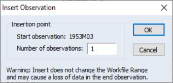

Inserting and Deleting Observations in a Series
You can also insert and delete observations in the series. First, click on the cell where you want the new observation to appear. Next, right click and select or from the menu. You will see a dialog asking how many observations you wish to insert or delete at the current position.
If you choose to insert a single observation, EViews will insert a missing value at the appropriate position and push all of the observations down so that the last observation will be lost from the workfile. If you wish to preserve this observation, you will have to expand the workfile before inserting observations. If you choose to delete an observation, all of the remaining observations will move up, so that you will have a missing value at the end of the workfile range.

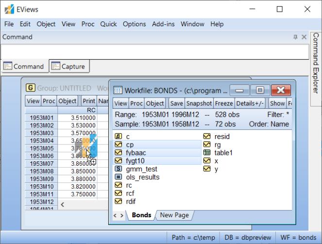

Creating Groups

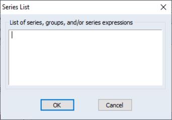

There are several ways to create a group. Perhaps the easiest method is to select from the main menu or workfile toolbar, click on , and if desired, name the object.
You should enter the names of the series to be included in the group, separated by spaces, and then click .
You may use the wildcard characters “*” and “?” to match more than one series in the workfile, and you may use the keywords “and” and “not” to specify that certain items should be excluded from the group.

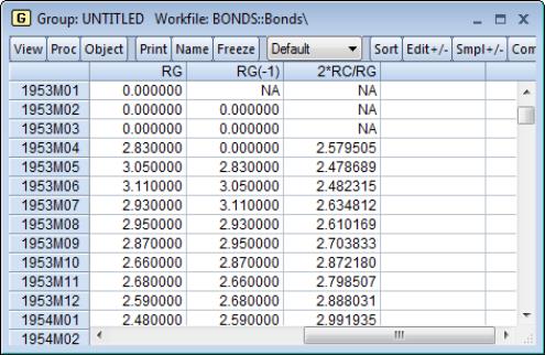

A group window will open showing a spreadsheet view of the group.
You may have noticed that the dialog allows you to use group names and series expressions. If you include a group name, all of the series in the named group will be included in the new group. For example, suppose that the group GR1 contains the series X, Y, and Z, and you create a new group GR2, which contains GR1 and the series A and B. Then GR2 will contain X, Y, Z, A and B. Bear in mind that only the series contained in GR1, not GR1 itself, are included in GR2; if you later add series to GR1, they will not be added to GR2.
Series expressions will be discussed in greater depth later. For now, it suffices to note that series expressions are mathematical expressions that may involve one or more series (e.g. “7/2” or “3*X*Y/Z”). EViews will automatically evaluate the expressions for each observation and display the results as if they were an ordinary series. Users of spreadsheet programs will be familiar with this type of automatic recalculation.
Here, for example, is a spreadsheet view of an untitled group containing the series RC, a series expression for the lag of RG, RG(–1), and a series expression involving RC and RG.
Notice here the setting for the group spreadsheet display indicates that the series RC and RG(-1) are displayed using the original values, spreadsheet types, and formats set in the original series (see
“Display Formats”). A newly created group always uses the display setting, regardless of the settings in the original series, but the group does adopt the original series cell formatting. You may temporarily override the display setting by selecting a group display format. For example, to use the display settings of the original series, you should select ; to display differences of all of the series in the group, select .

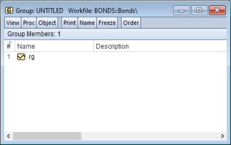

Adding to or Modifying a Group
You can add to or modify an existing group by clicking on .
Right-clicking will bring up a menu prompting you to or
• If you select , a additional line will be added to the current list view and you may enter the name or expression you wish to add. The order of entries in the group may be modified by dragging the entry to the desired position.
• If you select you will be presented with a text box showing all of the series in the group. To add new members simply edit the text box. Rearranging the order of names in the text box will rearrange the entries in the group. Click on to accept the changes.
• If you select entries, and right mouse click, you may use the entry to remove the selected series from the group.
