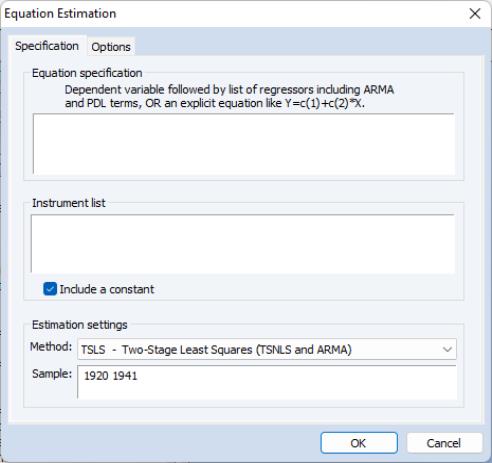

To estimate an equation using Two-stage Least Squares, open the equation specification box by choosing Object/New Object.../Equation… or Quick/Estimate Equation… Choose TSLS from the Method: dropdown menu and the dialog will change to include an edit window where you will list the instruments.
Alternately, type the tsls keyword in the command window and hit ENTER.
In the Equation specification edit box, specify your dependent variable and independent variables and enter a list of instruments in the Instrument list edit box.
There are a few things to keep in mind as you enter your instruments:
In order to calculate TSLS estimates, your specification must satisfy the order condition for identification, which says that there must be at least as many instruments as there are coefficients in your equation. There is an additional rank condition which must also be satisfied. See Davidson and MacKinnon (1993) and Johnston and DiNardo (1997) for additional discussion.
For econometric reasons that we will not pursue here, any right-hand side variables that are not correlated with the disturbances should be included as instruments.
EViews will, by default, add a constant to the instrument list. If you do not wish a constant to be added to the instrument list, the Include a constant check box should be unchecked.
