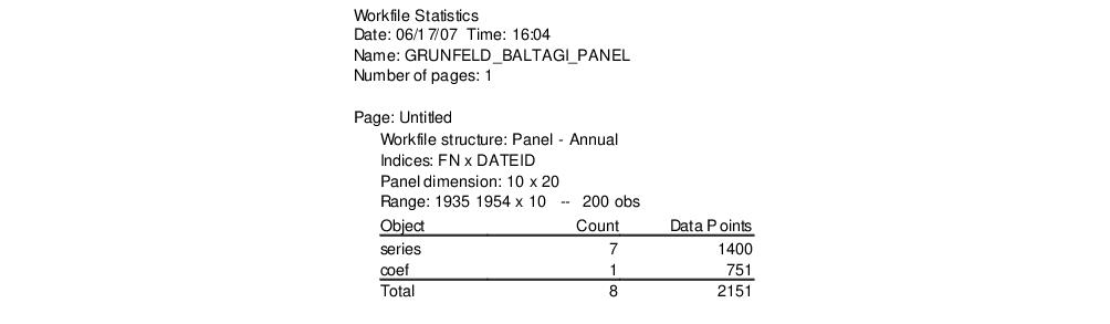

First, the workfile statistics view provides a convenient place for you to examine the structure of your panel workfile. Simply click on View/Statistics from the main menu to display a summary of the structure and contents of your workfile.
The top portion of the display for our first example workfile is depicted above. The statistics view identifies the page as an annual panel workfile that is structured using the identifiers ID and DATE. There are 10 cross-sections with 20 observations each, for years ranging from 1935 to 1954. For unbalanced data, the number of observations per cross-section reported will be the largest number observed across the cross-sections.
To return the display to the original workfile directory, select View/Workfile Directory from the main workfile menu.

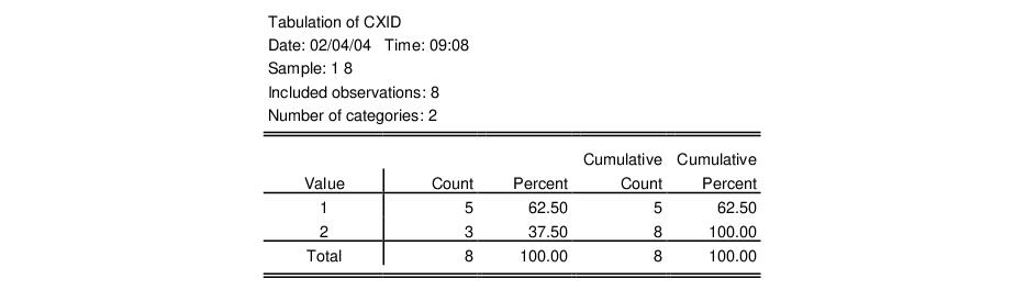

The series expression @crossid provides index identifiers for each observation corresponding to the cross-section to which the observation belongs. If, for example, there are 8 observations with cross-section identifier alpha series values (in order), “B”, “A”, “A”, “A”, “B”, “A”, “A”, and “B”, the command:
series cxid = @crossid
assigns a group identifier value of 1 or 2 to each observation in the workfile. Since the panel workfile is sorted by the cross-section ID values, observations with the identifier value “A” will be assigned a CXID value of 1, while “B” will be assigned 2.
A one-way tabulation of the CXID series shows the number of observations in each cross-section or group:

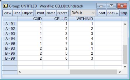

Similarly, @cellid may be used to obtain integers uniquely indexing cell IDs. @cellid numbers observations using an index corresponding to the ordered unique values of the cell or date ID values. Note that since the indexing uses all unique values of the cell or date ID series, the observations within a cross-section may be indexed non-sequentially.
Suppose, for example, we have a panel workfile with two cross-sections. There are 5 observations in the cross-section “A” with cell ID values “1991”, “1992”, “1993”, “1994”, and “1999”, and 3 observations in the cross-section “B” with cell ID values “1993”, “1996”, “1998”. There are 7 unique cell ID values (“1991”, “1992”, “1993”, “1994”, “1996”, “1998”, “1999”) in the workfile.
The series assignment
series cellid = @cellid
will assign to the “A” observations in CELLID the values “1991”, “1992”, “1993”, “1994”, “1997”, and to the “B” observations the values “1993”, “1995”, and “1996”.

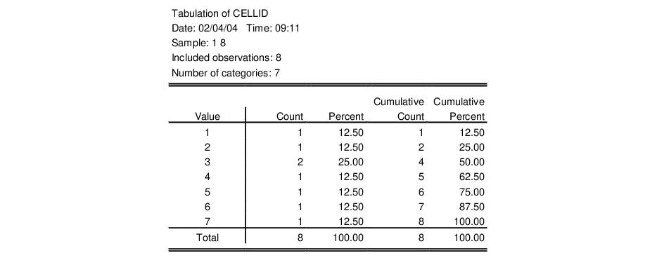

A one-way tabulation of the CELLID series provides you with information about the number of observations with each index value:

Alternately, @obsid returns an integer uniquely indexing observations within a cross-section. The observations will be numbered sequentially from 1 through the number of observations in the corresponding cross-section. In the example above, with two cross-section groups “A” and “B” containing 5 and 3 observations, respectively, the command:
series withinid = @obsid
would number the 5 observations in cross-section “A” from 1 through 5, and the 3 observations in group “B” from 1 through 3.
